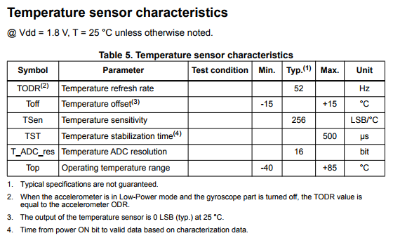

2018-05-14 7:53 AM
Here are the temperature sensor characteristics from the device datasheet.
As you can see the sensors measure difference values with respect to reference 25°C. The offset can be up to +/- 15°C.
2018-05-14 10:41 PM
Thanks Miroslav. So if we have multiple devices with this sensor, every device can have a different temperature offset, correct?
2018-05-15 3:08 PM
Yes, it is correct.
