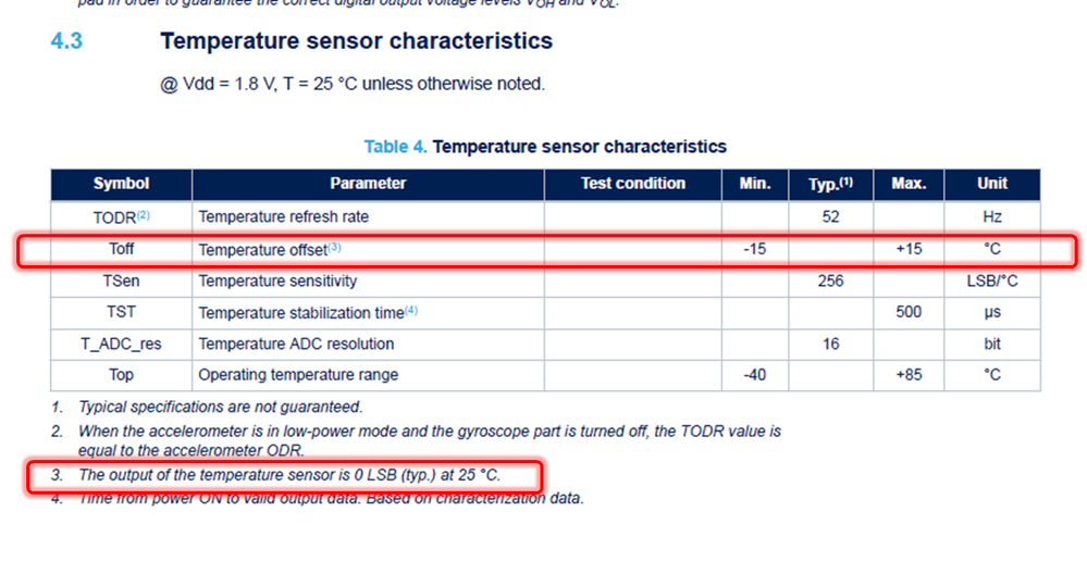

I'm using the temperature sensor in LSM6DSRX.
In page 12 (4.3 Temperature sensor characteristics) of the Datasheet (see the image), what is "Toff" (Temperature Offset)?
The Table 4 gives a range of -15 to +15 C for Toff, what is this range for? The Table also gives the operating range of -40 to +85 C.
I was wondering how to use "Toff" in calculating the temperature ?
Thanks for any help!

Hi @AFars.1 ,
the values declared in the datasheet refers to the maximum and minimum value for the offset at 25°C of the internal sensor. The typical value is however close to 0 (i.e., the T sensor effectively measure 25°C at true 25°C), and the range limits have a lot of margin.
For temperature measures that require deep accuracy, I suggest you to compare the value with the one of a reference temperature sensor at true 25°C and store the offset via software for real-time or post processing compensation.
For completeness, please consider the below formula for the temperature raw value conversion (source Github lsm6dsrx_reg.c:(
float_t lsm6dsrx_from_lsb_to_celsius(int16_t lsb)
return (((float_t)lsb / 256.0f) + 25.0f);
}In case this answer helped you, please select this as "best".
