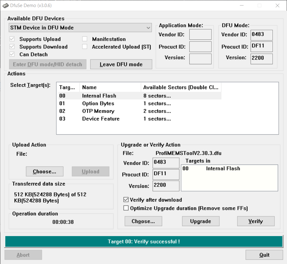

I am trying to get the STEVAL-MKI109V3 upgraded to support the STEVAL-MKI179V1.
When I first tried to use the 109V3, Unico said my firmware was out of date and needs to be updated to support the 179V1.
So I used Dfuse to update the part. I am using the firmware file "ProfiMEMSToolV2.30.3.dfu" in C:\Program Files (x86)\STMicroelectronics\Unico\bin\dfu
When I hit upload, I see erase and write and verify all succeed.
Problem:
After I exit DFU mode, the 109V3 still says it is at an old firmware version when I send the "*ver" command.
Questions:
2018-10-23 8:51 AM
You must hit the Upgrade button, not Upload.
