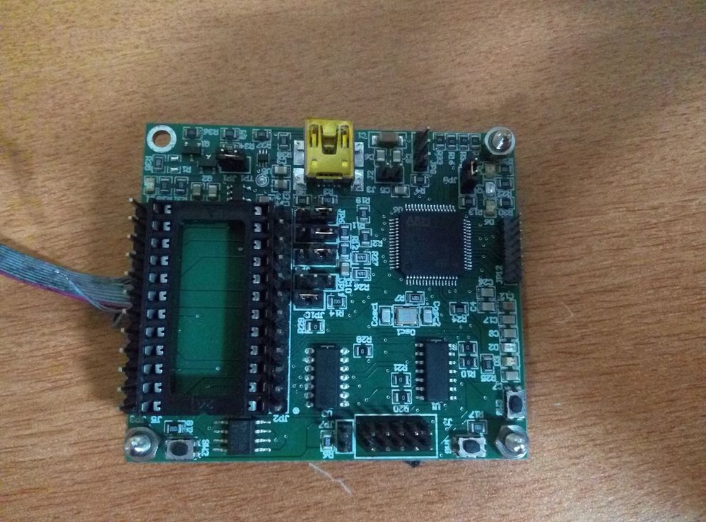

Hi I am using, ST eval (STEVALI109V2),suddenly its not working,its not giving usb port ,when i connected to PC, D1 & D5 LED are blinking,please guide me ,how to fix it.
Regards,
Chaitanya
2018-10-08 11:08 PM
part number of board - STEVAL - MKI109V2
2018-10-24 1:50 AM
Didn't you try to update the firmware?
2018-10-24 1:57 AM
I don't know how to update firmware for STEVAL-MKI109V2 ,can you guide me, how to update firmware ?
2018-10-24 1:57 AM
Thanks for replaying
2018-10-24 5:03 AM
Please donwload STSW-MKI109W and follow DFU User Guide located in DFU directory.
