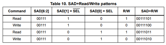

SEL (Pin 7] defines the I2C address, so you can have two devices on the same bus.
SEL = 0 ... I2C address is 0x1E (7bit)
SEL = 1 ... I2C address is 0x1D (7bit)
You cant read the data simultaneously on one bus, you have to alternate between the two sensors.
