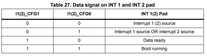

I suppose you already tried configuring the CTRL_REG3 [interrupt CTRL register] (22h) for the Data Ready routed on INT1(2) pad (datasheet, p.27):
0693W000008z5vaQAA.pngYou could try to enable the LIR1 bit and see if the interrupt is working at leas in latched mode.
You can also try to set 01h in the INT1_DURATION (33h) register.
-Eleon
