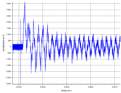

I want to detect a shock  with the H3LIS331DL and its interrupt on threshold level. I used it in normal mode and an ODR of 1000Hz. The shock in my testbanch is :
I want to know what is the minimum of time when the duration is setup to 0 with my ODR to set interrupt signal.
What is the answer of the sensor when the shock is an high frequency one...
There is few information about the bandwidth of the sensor or about its transfer function in its datasheet or application note.
Thanks for your help

Hi @David45 ,
You can't find information about bandwidth and transfer functions because they are confidential and require an NDA. To get them you could contact Online Support at this link.
