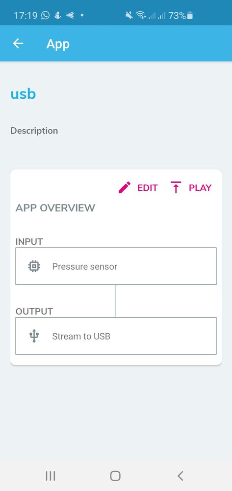

Hi @TJM , discussing with our SensorTile.box FW experts, the source code doesn't includes that kind of error messages, they have to be generated from Linux. You say they are generated when the ST.box is connected via USB cable, right? Can you please do these two tests?
