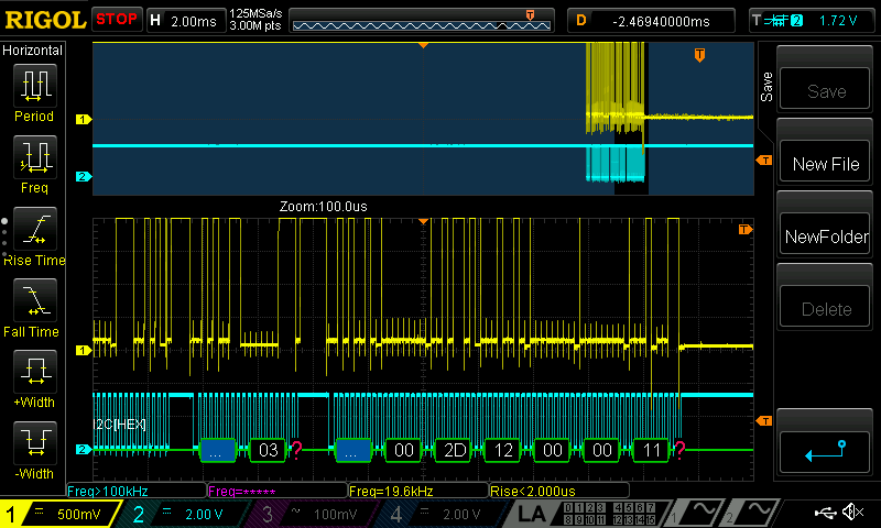

Fig. 1: Failed rangefinder initialization. Yellow: SDA, Cyan: SCLFig. 1: Failed rangefinder initialization. Yellow: SDA, Cyan: SCL

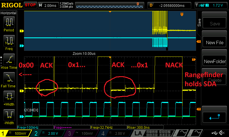

Fig. 2: Premature ACK and rangefinder holding SDA low.  Yellow: SDA, Cyan: SCLFig. 2: Premature ACK and rangefinder holding SDA low. Yellow: SDA, Cyan: SCL
As in the captions, the yellow trace is SDA and cyan is SCL.  The current CircuitPython instruction being executed is line 194, `self._write_register(0x002D, init_seq)`.  You can see that in the decoded section of Fig. 1, where the Pi has written to register 0x002D bytes 0x12, 0x00, 0x00, 0x11 from the initialization sequence.
As far as I can tell, the slightly lower SDA voltage is the rangefinder pulling down to write to the bus or ACK, which is the basis of my suspicion for premature ACKing.  As you can see in the second figure, the previous byte 0x00 was ACK'd successfully and the Pi moves to sending the next byte.  On the fifth bit, the rangefinder ACKs again (which will clobber a 1 if the Pi was trying to write, which is what tipped me off to this problem in the first place) and is now out of sync with the byte-stream.  The Pi interprets the rangefinder's silence as a NACK and releases SDA, but sometimes (as shown above) the rangefinder then takes SDA and holds it low until I power cycle it.

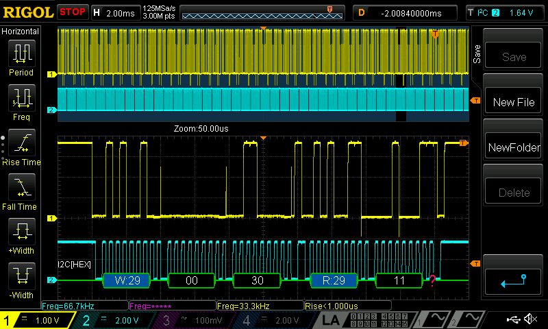

To try and simplify the software side of things, I connected it to an Arduino Mega, using the relevant software library. I was too lazy to disable the internal pull-up resistors on the I2C pins, so the bus voltage is a smidge higher but still (barely) within the datasheet allowance.  Shown below is successful communication with the same rangefinder as in the traces above.  I have seen at least one out-of-turn ACK with the Arduino but I don't have a good picture, and it happens much more infrequently.  The one difference I see is the Arduino seems to add a couple μs of clock delay (I don't know if you call that clock stretching if it's on the master side) between bytes.  I have not yet tried banging in the same behavior in the Pi.  The message shown is part of the polling loop querying register 0x0030 to see if data are ready to be read.
Fig. 3: Successful communication with the Arduino. Yellow: SDA, Cyan: SCLFig. 3: Successful communication with the Arduino. Yellow: SDA, Cyan: SCL

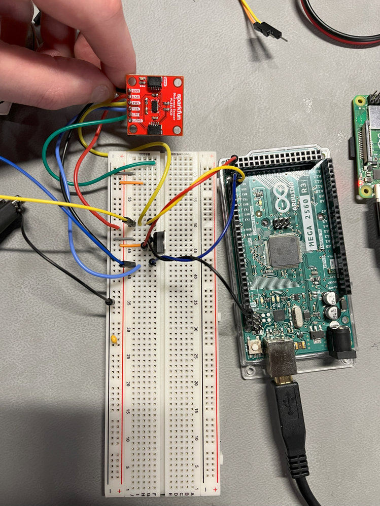

- I removed the address translator/level shifter from the test setup not long after I started trying to solve the problem, for the sake of simplicity.  I've included a picture below of my test setup with the Arduino (not pictured: additional 1k2 pull-up resistors).  Per your suggestion in a previous post I had twisted SCL and GND together.
