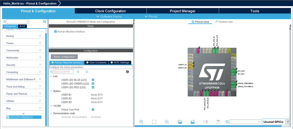

2025-11-18 5:26 PM
I have an update and a temporary workaround.
By comparing the generated code from a project with X-CUBE-MEMS1 enabled against one without, I found that the build errors are resolved by making two manual changes:
#define BSP_B1_IT_PRIORITY 15U
#define BSP_B2_IT_PRIORITY 15U
#define BSP_B3_IT_PRIORITY 15U
The project now compiles successfully.
However, the main issue now is that these manual changes are overwritten and lost every time I modify the .ioc file and regenerate the code. Is there a way within CubeMX to make these settings permanent, or does this seem like a bug in the code generator for this software pack?

2025-11-19 5:30 PM
You'd have thought that should be covered by this setting:
Thank you for your response. And I also had the same expectation that the code generator would define everything automatically.
As my screenshot shows in above reply, the problem starts the moment I enable the X-CUBE-MEMS1 pack. The BSP IT priority definitions are removed and USE_BSP_COM_FEATURE changed to 0U.
You should be able to find a place within a USER CODE section to prevent that ?
(Of course, this doesn't alter the fact that you shouldn't need to do it at all)
I have tried placed those definition code in USER CODE Header block in stm32wbaxx_nucleo_conf.h. The code disappeared once I run "Device Configuration Tool Code Generation".
