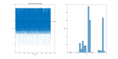

We managed to get data with the MEMS configurator. But we have main issues.
We configurated the sensor HUB ODR to 240Hz, but we managed to get data at approx 166Hz
Timestamp variation are pretty important :
* The most common timestamp delta is approx 6ms (approx 166Hz ODR)
* There is a lot of variation on our dataset
* Pedometer value and activity value shows no changes.
Please check the json configuration, the result file and the timestamp delta graph.

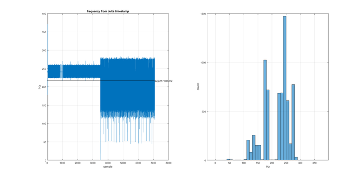

I have created a small Matlab script (.m.txt attached) to load and plot the frequency extracted from the timestamps in your csv (frequency plot attached) - looking at the histogram, it seems the system is trying to keep up with the high datarate but cannot do it. Here is the plot of the frequency from your csv:

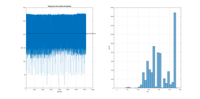

Then I have tested your json design (very well done by the way) with my SensorTile.Box PRO. I took the log with MEMS Studio (ST_Data_Log...) while also the log was being saved onto the SD card (ST_test_....). I used the same small Matlab script to load and plot the frequency extracted from timestamp.
Now look at the plot of the csv from MEMS Studio: when the system is NOT writing to the SD card, the timestamps indicates the target 240Hz is achieved. When the system starts writing, the issue happens and the average drops down. Values in the log on the SD card do match the second part of the log taken from MEMS Studio.
In the end it seems that the AlgoBuilder FW cannot handle the slow write process to the SD Card. The safest way to go around this would be to use FreeRTOS and have an independent task with dedicated buffers to handle the writing to SD card. While the main task/loop handles the data readout process (this is how the DATALOG2 firmware is designed to handle high data rate log).
So, it seems that you would need to take another step up and code your own application. No-code and low-code solutions are not enough for your case. Use the AlgoBuilder generated code as a reference.
