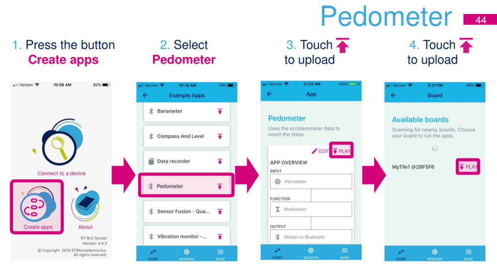

Hi @extraspicy , you might find useful this presentation about how to set the pedometer application.
The pedometer runs at ODR > 26Hz, so the battery should las about 1 day.
The pedometer is based on the accelerometer data, but they will be available at the pedometer frequency, so not sure you can get the raw data together with the pedometer.
