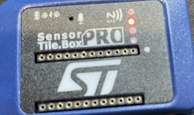

I found there is more more blue LED for BT pairing. only red LED

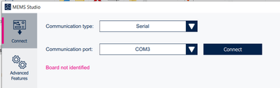

so I copied the dtm.bin to the SD card and do the firmware upgrade as the picture
but I cannot connect to the SensorTile. Phone App can find it and connect to it but inside functions do not work(like the dice. motion)

With the original sensortile.box PRO fw you cannot use the MEMS-STudio SW (as your picture) but only the "BLE sensor app" via smartphone.
