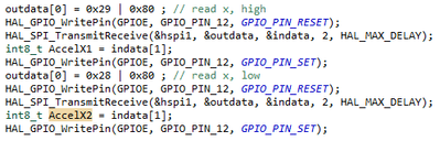

I have set the accelerometer to work at 104 Hz and 4g. My current calculation of accelerometer data is based off of the code I found in the SensorTileBox-BLESensors project from the FP-SNS-STBOX1 function pack. Here is the code (for the X axis, Y and Z are also calculated like X) I am using to get the acceleration data and convert it to the [mg] unit:
For instance the data I received from the app while the SensorTile.box was stationary, was around 993 mg on the Z axis. When I used my own project and the SensorTile.box was in the same position, the data was around 960 mg on the Z axis. That is why I am assuming that I am not converting the data correctly.

Hi @Bxy ,
Lookig at your code, you write:
the correct form should be:
int16_t     AccelX;
int32_t      AccelX_mg:
AccelX= ((int16)AccelX1 <<8 ) | AccelX2);
AccelX_mg= (int32_t)((float)AccelX * LSM6DSOX_ACC_SENSITIVITY_FS_4G);

Thank you, I seem to be getting just about the same values now.

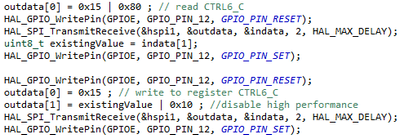

Because currently, I am just setting the accelerometer to 104 Hz ODR and 4 g FS as such ( in the CTRL1_XL register):
I would also guess that Low power Power mode means disabling high-performance operating mode in the CTRL6_C register like this:
So I would appreciate it a lot if you could tell me how the LSM6DSOX is being set up when using the app. Again thank you very much for your help.

The settings you use are the same of the app, because the fw performs the same operations.
The only difference could be in the ODR: the setting for the sensor is the same (write 0x48 in register 0x10) but for some ODRs the timer at which the data is read/written is slightly different (for example it could be 100 instead of 104)
If this difference is important to you I can check with the dedicated team and let you know.
If this helps you, please mark my answer as "Best Answer" by clicking on the "Accept as Solution" button, this can be helpful for Community users to find this solution faster.
