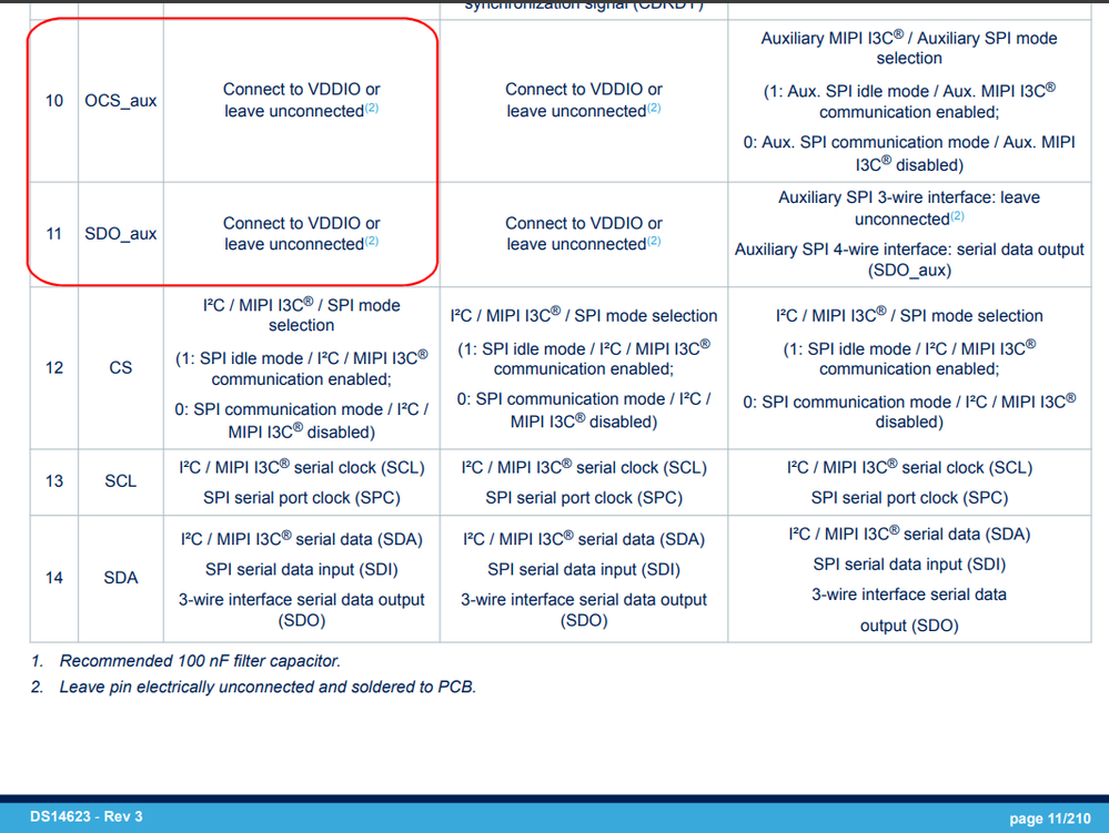

2026-02-13 6:44 AM
Elsewhere in the datasheet recommends connecting to VDDIO:
2026-02-15 4:14 AM
Hi
I guess the reason why the datasheet recommends it is because these pins have weak internal pull ups to VDDIO, if they are connected to ground there will be a small leakage current <1mA. Thats why its recommended in the datasheet to connect with VDDIO or leave floating, but functionality should be 100% intact.
