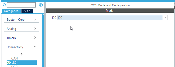

Federica Bossi
Hi @ggowd.1​ ,
Welcome to ST Community!
Using the utility STM32CubeMX you need to select the i2c peripheral under connectivity:
Bear in mind that you need pull-ups on the SCL and SDA lanes.
