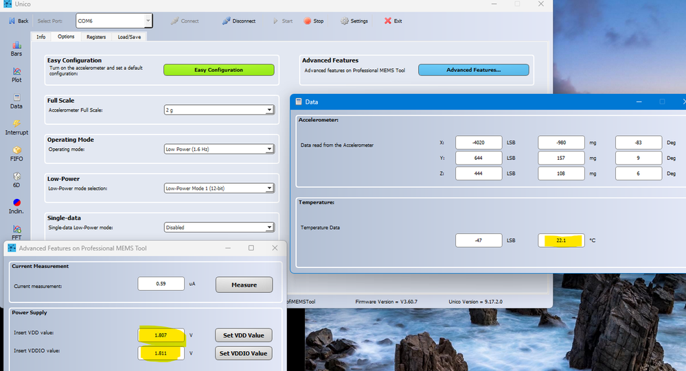

I know the datasheet specified that the +/-0.8°C was measured at VDC =1.8V, but my supply voltage is 3.3V. There are no heat sources on our boards, and the temperature measurements are done at 1.6Hz/12 bits, once every 30 seconds. The microcontroller is in sleep mode, and the power consumption of the board (LIS2DTW12, microcontroller and peripherals) is 0.9uA in sleep mode. The measurement takes a few ms and the current is as high as 75uA, every 30 seconds. That's not enough to heat the board and impact the measurements.
I used both low power 1.6Hz with 12bit and high performance 800Hz with 14bits, but other then the refresh rate and the LSB, there's no significant change in temperature measurements.

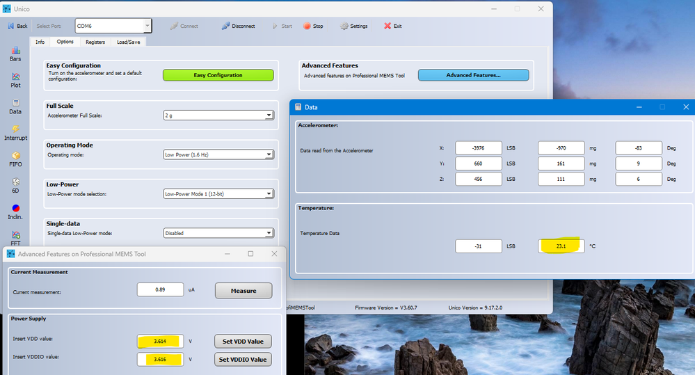

However, changing the VDD and sometimes the VDDIO as well from say 1.6V to 3.6V on the EV board with an MKI190V1 adapter on it will show changes in temperature measurements by as much as 3.5°C, always going higher with VDD. That's why I'm thinking there must be a correlation between VDD and the temperature value, and if that is true, a graph or a formula available, that would help a lot.
Also, one more thing: when testing temperature on the EV board, the longer I run the test, the bigger the error. It looks like there is a self-heating effect as well, so I ran the tests at low power 1.6Hz and 12 bits.
I also extended the MKI190V1 adapter with extra sockets. I used a set of intermediary pins to move the adapter away from the EV board, just in case the EV board is generating any heat.
Here are some tests done with the EV boards.

At VDD = 1.8V
At VDD = 3.6V
The tests done on the 100 boards we already built are in line with the measurements you see from the EV board: always a few degrees higher than the actual temperature.
