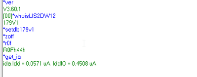

I think there is something wrong with your setup, this is my measurements using LIS2DTW12 and STEVAL-MKI109V3 and I confirmed what we declare in datasheet:
Please check your connections and layout.

Hello Federica,
Yes, I had a problem the the setup. I've also ordered the steval-mki109v3 and I will repeat the measurements, but I am pretty sure that the problem was with my setup.
Long story short: I used an STLINK-V3PWR board and the STM32CubeMonitor Power GUI to measure VDD, and it turns out that in dynamic mode, the resolution of the STLINK is not low enough for these kind of measurements.
I've already repeated the measurements using a X-NUCLEO-LPM01A board set in static mode, and I am getting IDD numbers very close to yours.
Thanks again for your reply!
