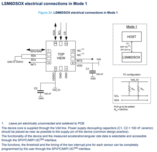

Is your schematic compliant with the datasheet instructions (p.39) or with the STEVAL connections?

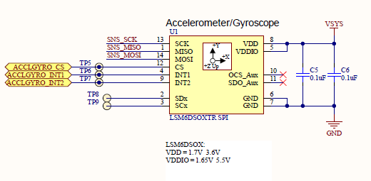

It is possible that we've got something like that happening here.... Yes....
Note on here that SDx and SCx are floating pins.

Hi @RLee.4 ,
Please note that the VddIO upper limit is 3.6V (datasheet p.13), while you are reporting 5.5V (that is also out of the absolute maximum ratings of 4.8V, datasheet p.16).
About the SDx and SCx left floating, the datasheet states that you have to connect them to VDDIO or GND (datasheet p.8)...
Could you try to check if you are still facing issues in this configuration? (I believe you could use the TP8 and TP9 test point to fixt the pins to one of the above voltages)
-Eleon
2021-03-17 6:54 AM
we're running that system at 3.3V so no worries there. The TPs on there make it easier to tie to something and I'll do that. Interestingly enough I don't see this problem a lot so the thing must be mostly stable with them floating.... I haven't run into the problem since I power reset it so I'm thinking this isn't happening with any regularity (a good but frustrating thing)...
