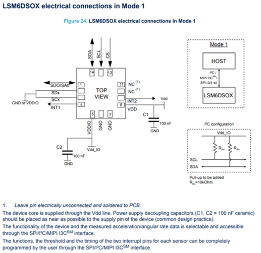

About the current issue, the only way the chip could reset is the case you deliberately enabled the SW_RESET bit of CTRL3_C (12h) register (datasheet p.53) but it seems not to be the case, or the Vdd falls below the minimum value (i.e. 1.71V). I'm wondering if there could be some issue coming from the multithread operation, for example due to interrupt handlers: is the hardware connection compliant with the connection suggested in the datasheet p.35?
Moreover, do you have the possibility to acquire (e.g. with a scope) the Vdd line during the multithread operation? Can you also check whether the configuration registers' values are 00h just after the step counter resets to 0?
