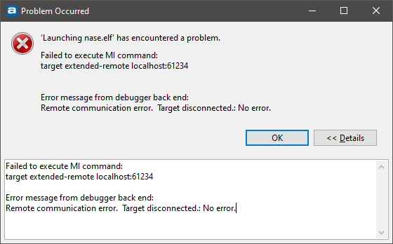

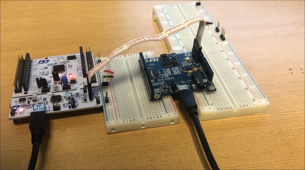

I am having a hard time getting started with the SensorTile and need some help. I am using CubeMx (v5.3.0) for the STM32L476JGYx selection, and observe the following result when I try to debug -
Here is the error message:
Here is the test setup:
Thoughts? What is causing this, how to correct?

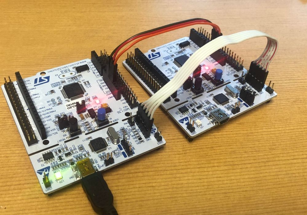

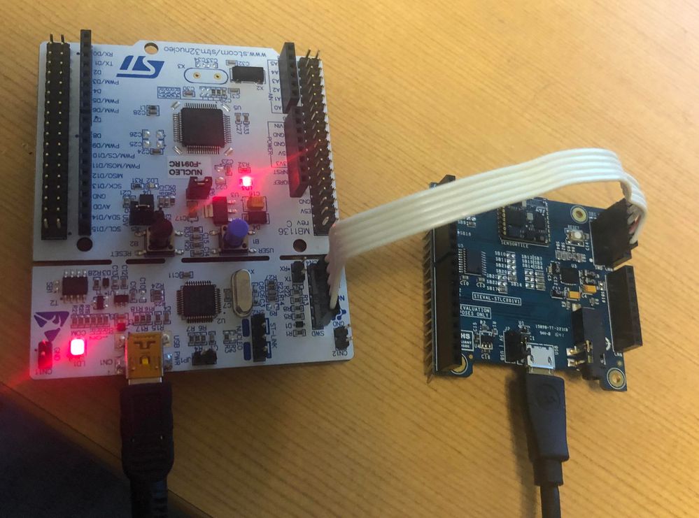

2019-10-16 4:25 PM
My gosh, now it all works - THANK YOU Jan!!
I have spent a lot of money, time and efforts into this, very grateful for your help resolving this. Here are my working configurations for future reference -
Thank you!
