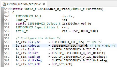

2022-12-08 3:33 AM
Hello, I tried your code and it works perfectly with only one minor but important change - if you have in your HW setup SA0 pin of the ISM330DHCX connected to VDD (like I do), you need to change the I2C address to high. See attached picture of the file/function/fixed value highlighted.
2022-12-08 3:37 AM
The comment
/* SA0 = GND */
is not valid anymore when I changed it from L to H, now it should be
/* SA0 = VDD */
but it's not important, just wanted to mention it to avoid misunderstanding. When you change it in in CubeMX and regenerate the code, the comment will change automatically to VDD.
