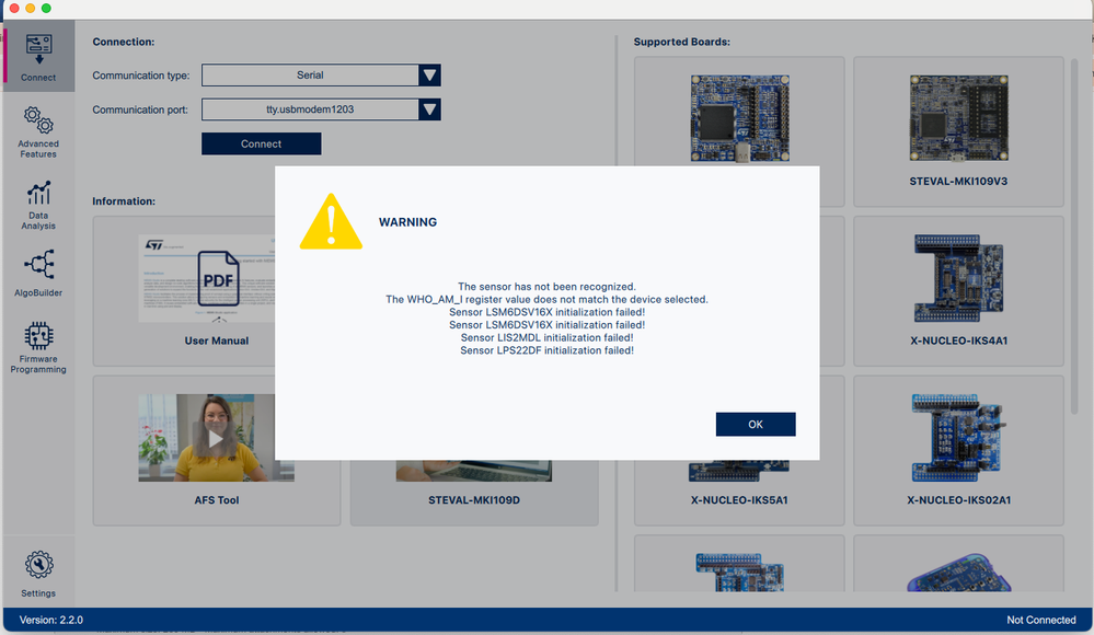

The WHO_AM_I register value does not match the device selected
joserp93
Associate II
The X-NUCLEO IKS4A1 cannot operate correctly in MEMS Studio with the default sensor selection on the board. I have the nucleo f401re.Screenshot 2026-01-08 at 12.50.59 PM.png
1 ACCEPTED SOLUTION
Accepted Solutions
It's working now; the IKS4A1 doesn't have the 3.3V and Vio pins soldered on. STM should be more careful with test PCBs.
