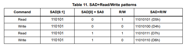

2024-05-08 8:26 AM - edited 2024-05-08 8:29 AM
@atamby187 wrote:The problem was with the i2c address of the Adafuit IMU which is 0xD4 (0x6A << 1) and not 0x6A as seen on Adafruit website.
An I2C address is just 7 bits, so Adafruit are correct to say that the I2C address is 0x6A = 110 1010
The value 0xD4 is made up of the address plus the R/W bit: 1101 0100 = 0xD4
This is a frequent cause of confusion:
As shown in the ST datasheet, the value 0xD4 is the "SAD+R/W" - ie, Slave ADdress plus the R/W bit:
2024-05-08 8:49 AM
Hi Andrew,
Thank you for the clarification. I am quite new in electronics.
