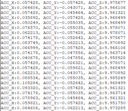

I am getting acceleration and gyro data using LSM6DSO32 chip. But I want to filter this data with internal filters, but I cannot activate the high pass filter of the accelerometer. In the code below, I want to send F4 (11110100) data to the CTRL8_XL control register, ie 0x17 register address specified in the datasheet, to set the cutoff frequency as ODR/800, but corruption occurs in the accelerometer data. How can I solve this?

I think LPF2 and HPF can not be enabled at the same time for the accelerometer. For this, I did not enable LPF2. Do I need to enable LPF2? Correct me if I'm wrong. The ODR I use is 104 Hz, but even when I do ODR/2, I see my accelerometer data incorrectly as shown in the figure. I also don't know how to fix this error.0693W00000Kd9gJQAR.png

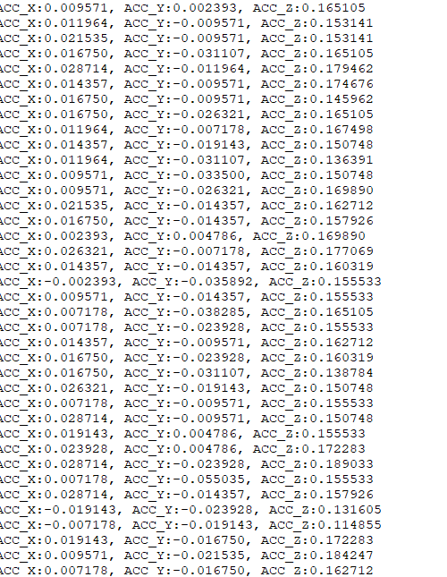

Thanks for your answer, my problem is solved as seen in the figure below. I sent the value "10000001" ie. 0x81 to the Z_OFS_USR register.
