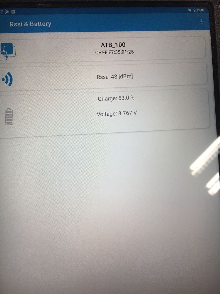

I have recently purchased Sensortile BOX , i can connect to it using st ble sensor application and it has a default cloud logging application.
I want to flash other applications like blemlc , etc ut not ale to connect to it

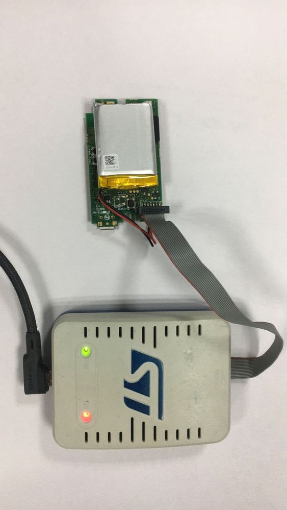

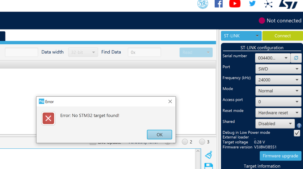

Attached are the pictures of the connection and issue.

Yes, it should be possible.
Did you try to erase the MCU memory and try to flash the code in JTAG (programming) mode or DFU mode? Here an explanation about how to do it --> LINK

Yes I tried erasing but the problem is "No STM32 Target found". I tried all the options of drop down ( USB, JTAG, DFU....)
Could be some issue with my connections or faulty cable.

I had a similiar issue with the Sensortile Devkit. Did you try holding the reset button while pressing connect while on the SWD connection? The reset mode should be hardware reset as shown in your image. May be this helps. :)
2022-07-13 2:55 AM
Thanks @SThek.1 , i will try this
