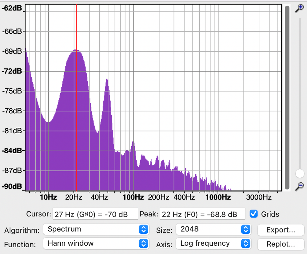

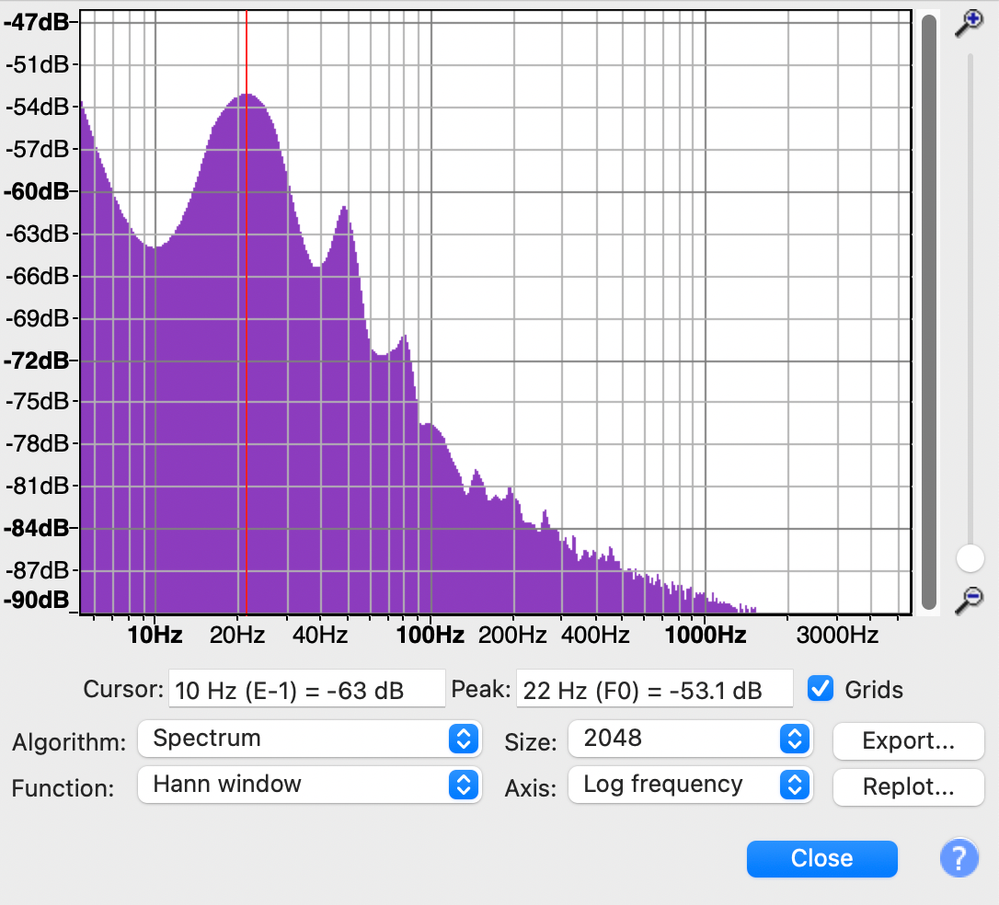

Here instead the high-pass filter alpha is 0.9 (see attached track). I'm also reporting the two frequency spectrum from audacity.
Here alpha 0.9.
0693W00000aJQbKQAW.pngHere alpha 0.98.0693W00000aJQbFQAW.pngIs this related to the microphone self-noise?
