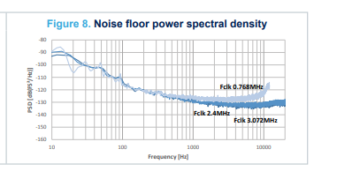

You find the noise floor at page 6 of the datasheet:

Yes I have seen that, I've spent some time looking at the datasheet, but my problem is I don't understand how to relate those figures to actual measurable noise in the PCM data as digital peak to peak values.
For example, if I have the microphone isolated from any sound, capture the PCM data as 16 bit signed values and analyse it in a spreadsheet I can get peak to peak and RMS noise figures, but I don't know how to relate this to the specification for the microphone so that I know my system is performing roughly OK.
My figures just seemed quite large, so I'm wondering if I have some problem.
Thanks
Julian

Hi @JKing.3 ,
What integral noise value do you get (with a 20Hz-20kHz bandpass) and applying the A-weighting filter? For MP23DB02MM you should obtain noise = sensitivity - SNR = -26dBFS -65dB(A) = -91dBFS(A)
Hi Federica,
I will need to check my data properly, but I'm sure it's much higher than -91dBFS(A).
Around -90dBFS(A) was the calculation I made from the data sheet, but I thought it seemed like a very low level of noise, but you have confirmed that this is the correct figure - thank you.
