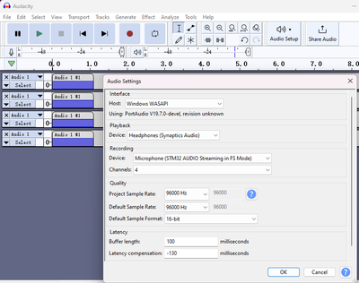

I used Audacity to sample the data in an quiet environment, with the configuration as figure 1. The sampling rate is 96kHz.

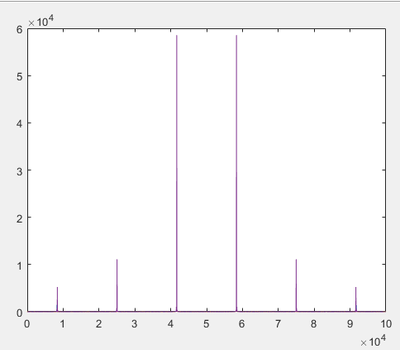

The DFT of 10,000 data points is shown in the next figure, we can see a very high noise level at around 40k, 24k, and 8kHz.
Is there any thing I can do to fix this problem?
