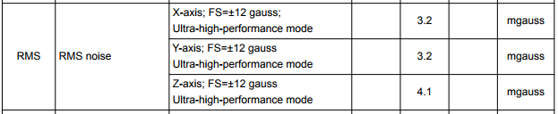

What is the magnetic rms noise of the LSM9DS1? I can not find it or something simular in the datasheet. Thanks for your help.
#magnetic-rms-noise2018-04-16 11:38 PM
Magnetometer part of LSM9DS1 is basically the same as LIS3MDL.
