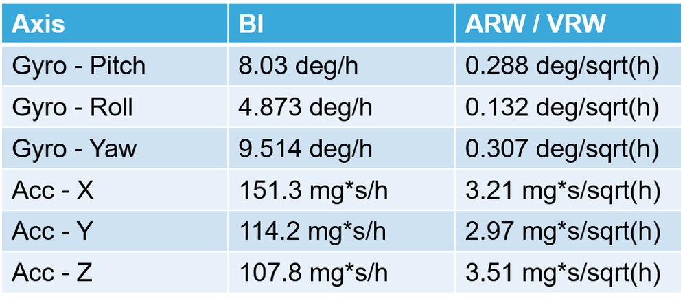

I will consider your suggestions but for now, I need sensor noise characteristics for my EKF alghoritm. I am considering to get sample datas for an hour and will use for Allan-Variance analysis.
If you have Allan-Variance analysis code or results, can you share with me?
Hi @KDoga.1​ ,
No problem.
I can share you the average values for the Bias Instability (BI) and for the angular or velocity random walks (ARW/VRW), for a device similar to the LSM9DS1, that should be quite representative of a standard lot population.
0693W000005ABqXQAW.png-Eleon
