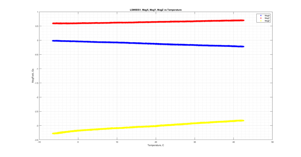

2018-07-07 1:35 AM
Yes, magnetometer offset depends over temparature and have to be compensated.
PS My evaluation board was fixed to metall surface by
magnetic fasteners, that is why absolute value of measured magnetic field more than Earth magnetic field value.
Temperature compensation bit was set.We’re moving the ST Community to a new platform to give you a better and more reliable community experience.
