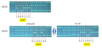

I'm experiencing the same issue with LSM6DSV320X (on STEVAL-MKI251A evaluation board) - WHO_AM_I returns 0x64 instead of 0x73 when using SPI.
My Setup:
  • Sensor: LSM6DSV320X (STEVAL-MKI251A board)
  • MCU: xiao ESP32S3
  • Interface: 4-wire SPI, Mode 3 / Mode 0

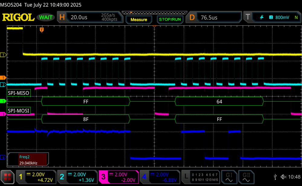

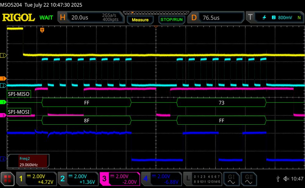

Interesting finding:
While testing with external pull-up/pull-down resistors on the SPI lines to see if it would affect the communication, I noticed something unusual:
When I physically touch the SCK line (even through the resistor lead), the WHO_AM_I register occasionally returns the correct value 0x73 instead of 0x64. This behavior is inconsistent and seems to depend on skin moisture/capacitance.
  • External resistors (1kΩ - 10kΩ) alone have NO effect
  • Only human touch changes the behavior
  • The effect is not always reproducible
This suggests the issue might be related to:
  • Signal integrity / impedance matching on SCK
  • Rise/fall time requirements
  • Capacitive loading effects
    I have recorded a video showing the oscilloscope waveform changes and WHO_AM_I value changes when touching/not touching the SCK line with the breadboard setup. (attached)
    Has anyone else observed similar behavior? Could this indicate a PCB design issue with the STEVAL-MKI251A board, or perhaps specific signal conditioning requirements for the LSM6DSV320X SPI interface?

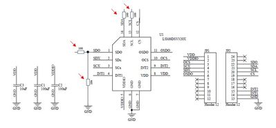

Following up on my previous report about the SPI communication instability (the "touching SCK changes behavior" phenomenon):
Solution Found:
Adding series termination resistors resolved the issue.
Hardware modification:
100Ω series resistors on SCK, MOSI, MISO lines (between sensor and MCU)
10kΩ pull-down resistor on MISO line (sensor side, close to chip)
Test Environment:
Sensor: LSM6DSV320X (STEVAL-MKI251A evaluation board)
MCU: ESP32-S3 (Seeed XIAO ESP32S3)
Interface: SPI, Mode 1
Connection: ~50mm jumper wires between sensor and MCU
Results:
WHO_AM_I register reads correctly and consistently (0x73)
All registers read/write stable, including sensor data burst read
No more intermittent communication errors
Important Finding:
I had similar SPI communication issues with ISM330DHCX (another ST MEMS sensor) in a previous project. At that time, I gave up on it and used another company's chip. However, when I applied the same series termination solution to ISM330DHCX, it also resolved that issue. This suggests similar signal integrity requirements may exist across ST's MEMS sensor family.
Note on Component Values:
The 100Ω value worked for my specific setup (ESP32-S3, 50mm wires, direct connection). Optimal values may vary depending on:
MCU type and SPI driver characteristics
Wire length and PCB layout
Sensor board design
I don't have equipment to measure precise impedance matching or signal reflection, so these values should be considered a working example rather than universal recommendations.

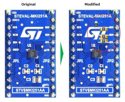

Implementation:
Since I couldn't place components between MCU and sensor board in my final design, I modified the STEVAL-MKI251A evaluation board by soldering chip resistors directly on it (see attached pictures).
If you have space outside of the board, you can also try using axial resistors or similar components.
Since the evaluation board doesn't have resistor footprints for series termination, I had to solder chip resistors directly. Would be nice to have those pads in future revisions!
