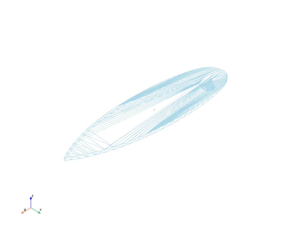

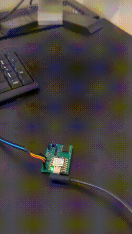

To recap my issue (as after reading my first post it did not seem super clear...), here is a video of the movement I apply to the device:

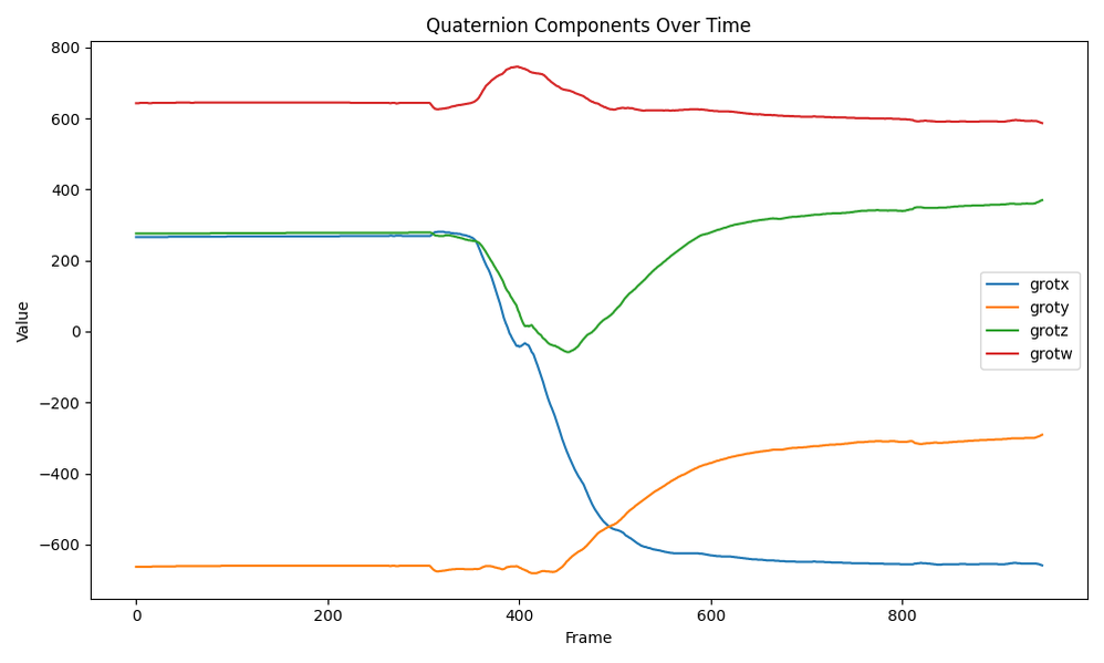

Here is a plot of the quaternion data I read from the device corresponding to this movement:Quaternion.png
I have a script that displays a 3D model of a surfboard and orients it according to the received data, which looks like what is in my original post. You can see rotations around two axis, where I only rotate the device around one axis.

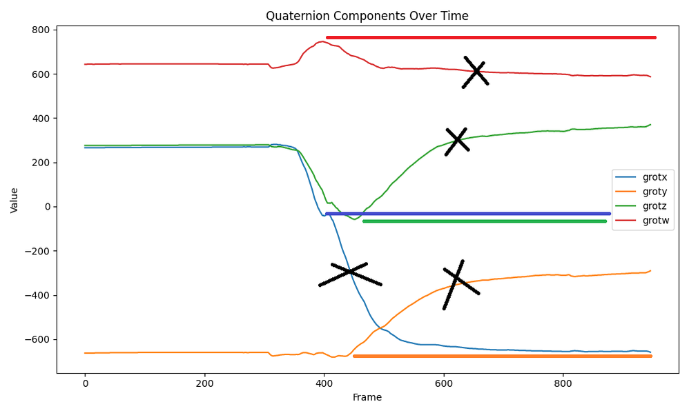

I would have expected the graphs to look like this:
That is, the quaternion data stabilizes after the move. It is what I observe when using Unico and the STEVAL MKI234AA.
