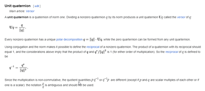

You wrote that: the game rotation vector data is sent as quaternions, so the 0.99951172 figure represents a quaternion component.
However you can refer to the AN5922 where in section 9.6.3 we explain that: Game rotation vector: X, Y, and Z axes (vector part of the quaternion) are stored in half-precision floatingpoint format, where w (scalar part of the quaternion) is computed in software after reading the data from the FIFO, since the game rotation vector is a unit quaternion.
For more details you can also look at wikipedia
Hi Federica,
I appreciate the help, but that's not the issue. We do calculate the w component of the quaternion from the x^2 + y^2 + z^2 + w^2 = 1 equation. Let's assume z=0.99951172, x and y are 0. From that equation, one can calculate w being 0.03124614504. So we get a quaternion of the form:
x=0, y=0, z=0.99951172, w=0.03124614504
Converting that quaternion to an angle, we get z=176.4188726 degrees as a result. It's physically impossible to get anywhere closer to 180 degrees, because that would need the z value to be closer to 1. For example, to get 178 degrees, we would need z=0.9998477, which will be rounded to either 1 or 0.99951172 because of the half precision. Therefore there is a significant gap between about 176 degrees and 180 degrees that are unrepresentable.
This is our problem.
