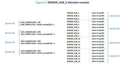

}But we found that the above code slv_len(Slave0_numop[2:0]) shouldn't exceed 7 according to following figure from datasheet:
What does this sentence "If the data are non-contiguous, you could configure several readings separated by the right points." mean? Can you provide some more detail information about it? Thank you very much.
