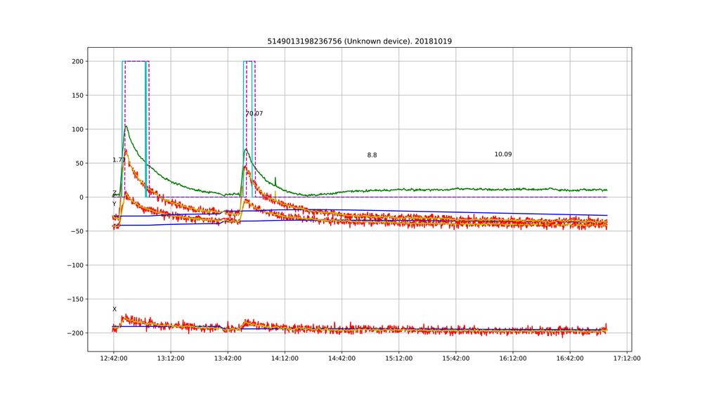

Temperature compensation for this magnetometer is not working as I expect. When heating device from room temperature to 50-60 degrees Celsius in 3 minutes magnetometer values are changing a lot.
I have 100Hz ODR, high-precision mode, temperature sensor and temperature compensation enabled, offset cancelation disabled.
Anyone having an idea what else should I set up? What is the normal (delta C / minute) which sensor can work with while compensating properly?

What it means the values are changing a lot?
Can you please share your results and exact sensor configuration so I can check it?
2018-10-22 5:41 AM
@Miroslav BATEK
Here is the log from the device, raw value is plotted in red. So change is around 100, 50 and 15 mGauss for Z, Y and X axes respectively.
I would be happy if all 3 axes will behave as X but in current setup it gives me false positives.

2018-10-25 1:32 AM
@Miroslav BATEK did you have any chance to look at it? Is it normal behavior of the sensor or not?
2018-10-25 1:41 AM
You have to also enable offset cancellation, to achieve specified offset vs temperature.
