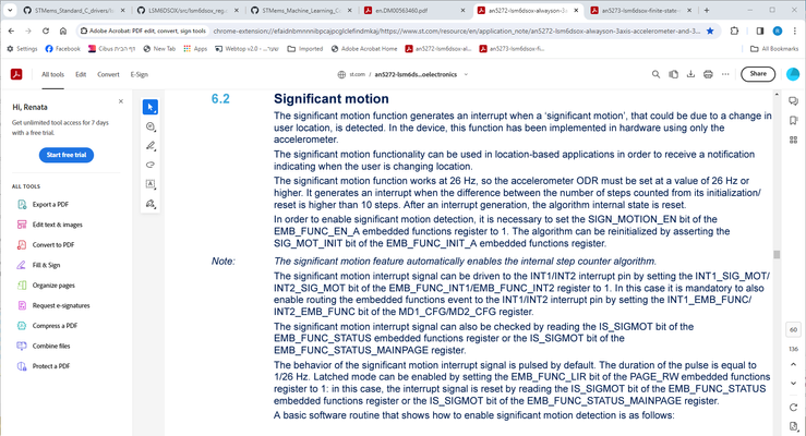

lsm6dsox sensor generates significant motion interrupt when a change in user location is detected. It generates an interrupt when the difference between the number of steps counted from its initialization/reset is higher than 10 steps. So it uses step counter. I need to detect the difference the user location by significant motion on 3 steps. please help me how i should change the significant motion feature to detect the user location on 3 steps.

Yes.My cpu is STM32H757AII6 .my MEMs sensor is KSM6DSOXTR.
I used by "an5272-lsm6sox-alwayson....pdf" to configure my MEMs sensor to work on "Significant motion mode".
Please see:
I've configurate my sensor according to the rules from this document. As you could see, the significant motion mode works only after more than 10 steps - I need 3 steps. what/how I should configure my device to work in the mode only after 3 steps. Please help me. Thanks.
