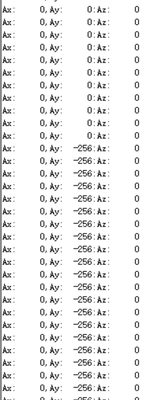

My STM32 can only correctly retrieve data from LSM6DSL when debugging. The code remains unchanged. When debugging, I get the correct data; without debugging, I get incorrect data.My SPI frequency is limited to 8 MHz, and there is a delay of more than 200 microseconds inserted between each SPI send and receive call to ensure sufficient preparation time for the sensor.I have removed all irrelevant code.The problem seems absurd but has been troubling me for a long time.It's worth noting that even without debugging, I can correctly read the 'WHO AM I' register. This is what's causing me great confusion since the communication seems to be fine
In non-debug mode, the data register can only be read as 0 and 255 as log

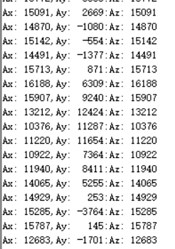

If I start debugging mode, I don't need to perform any operations on the microcontroller. I just need to reset it and run at full speed. With the same code, I can obtain the correct data.
