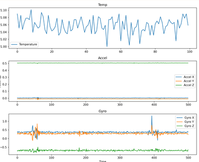

Small programs that plots the lsm6dso outputs, as I turned the imu, the 0.5 g readings moved to the other axis

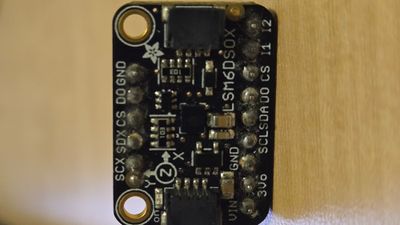

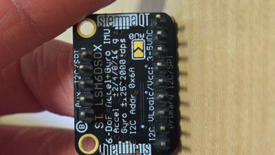

Also, this breakout board was bought from adafruit and its listed as lsm6dsox, which according to their datasheet is the lsm6dso not the lsm6dso32.

In the page you have linked, there is a link to the schematic overview: Overview | LSM6DSOX, ISM330DHC, & LSM6DSO32 6 DoF IMUs | Adafruit Learning System
In that page they confirm that there is a variant of your board that indeed utilizes LSM6DSO32 ! You probably have this variant (the so-called "industrial" variant)
In the breakout board itself is written LSM6DSOX, but i guess at this points it's worth testing it the code the 32g variant
