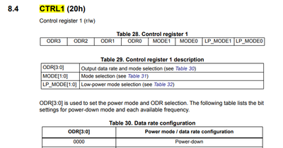

I have set the registers as follows.
CTRL1=00000100
CTRL2=00001100
CTRL3=00000000
CTRL4_INT1=00000100
CTRL5_INT2=00010000
CTRL6=11000100
CTRL_7=10100000
FIFO_CTRL=00000000
The temperature range is +20°C to +40°C.
If there are any errors in usage, please let us know.

Hi @t-susaki ,
I am a little bit confused. In CTRL1 you write 00000100 so you are setting the high performance mode but the sensor is in PD?
2025-03-13 5:00 PM
My apologies. I did not explain myself well enough.
Our product is battery-powered, so when it is not measuring, it is in power-down mode to reduce power consumption.
When measuring, the CTRL1 register is rewritten to '01010100' and returned to '00000100' when the measurement is finished.
