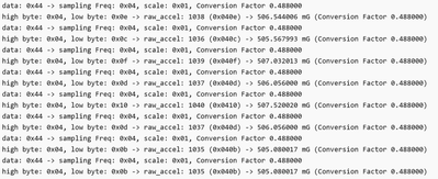

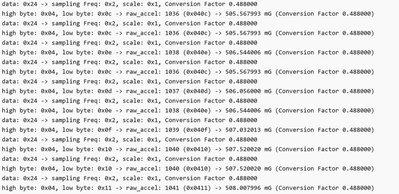

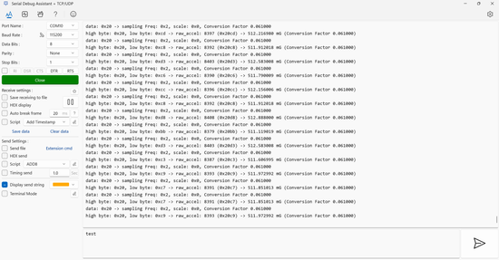

The first line shows the reading from the CTRL1_XL register and breaks it down into the configurations in that register (which in this picture is set up to +-2G range and sampling of Hz)
the second lines show the reading from the OUTZ_L_A (2Ch) and OUTZ_H_A (2Dh) registers, then it combines that into the raw data and multiply by the sensitivity factor suggested in the data sheet for each range ( in this case 0.0061)

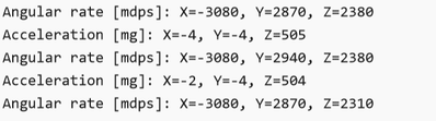

Small programs that plots the lsm6dso outputs, as I turned the imu, the 0.5 g readings moved to the other axis

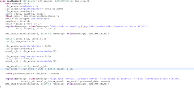

Here is the part of the code, in this section I its not exactly the library i am writing but it has follows the same procedures and gets the same numbers.

If you look at the first picture on the original post i am reading the data directly from the registers. I am reading CTRL1_XL, which contains the FS. On that picture is set to 0x0 so the conversion factor is 0.061 and if you multiply that number  by the value read by the 2 registers for the z axis you still get 0.5G. I also tried different FS ranges, the number changes but after multiplying everything I still get the 0.5 G.

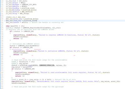

Yeah, I tried that as well the code is below, i think the setup is correct, at least i got no error in initialization and it was still reading 0.5 G.
A quick look at the screenshot of your C code seems to point to a data conversion problem: you read two uint8 and then make up a uint16 value out of it. But the accelerometer output is a SIGNED int16.

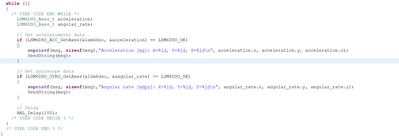

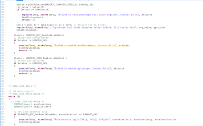

Even using the official driver i still get the 0.5G reading, the picture for the code is in the reply above
