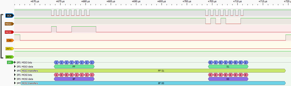

2023-02-07 5:30 AM
I know the thread is pretty old but I'm having a similar issue.
I'm trying to communicate with an LSMDSO on STEVAL-MKI196V1 and they always return 0x50 or 0x51 to the read of the WHO_AM_I register.
Connection is similar to many others:
-Vdd = 3.3v
-VddIO = 3.3v (tried also with 3.05V as the voltage in the microcontroller board is ~3.05V)
-SDO = SPI MISO
-SDA = SPI MOSI
-SCL = SPI clock
-CS = SPI chip select (Negated, 270kOhm pull-up)
-SCx = GND
-SDx = GND
-GND = GND
-OCS = floating
-OSDO = floating
The scope shows clean edges.
If I ignore the WHO_AM_I, I can configure the registers. I can configure resolution, frequency, interrupts, etc. To be honest, I have another issue as INT1 is triggered with accelerometer data, but when I try to check STATUS_REG, the flag XLDA is always 0, but that might be an issue with the configuration.
This is a capture of the logic analyzer in the WHO_AM_I register reading:
What I found weird is that this behavior is consistent when the supply is stable, but then I realized that if I turned off the LDO, VCC didn't really go to 0V due to leakage from logic analyzer and microcontroller, it stayed at ~2.4V and at that voltage, WHO_I_AM returns 0x6C!!!
The behavior is exactly the same on both STEVAL-MKI196V1 I have.
Is there any explanation for the error in the WHO_AM_I register???
