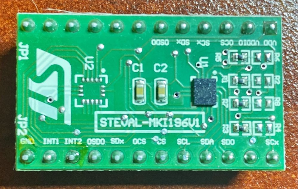

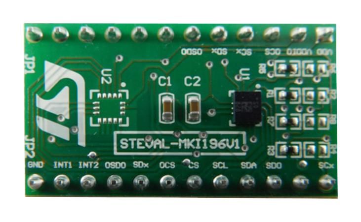

Attached is a picture of the STEVAL-MKI196V1 board that we are using. We didn't move the Resistors R3, R7, R1 & R5. This is the default configuration that we received them at.
The pin configuration was:
-Vdd = 3.3v
-VddIO = 3.3v
-SDO = SPI MISO
-SDA = SPI MOSI
-SCL = SPI clock
-CS = SPI chip select (Negated)
And the rest of the pins were floating. That means SCx and SDx pins were also floating.
As you suggested, we also tried connecting SCx & SDx to:
a- Ground
b- Vdd (3.3v) in our case
But in both cases we still get 0x50 for the WHO_AM_I command.
We also tested this on the STEVAL-MKI197V1 (connecting both SCx & SDx to GND - Testcase 1 and to Vdd Testcase 2) and it was also repling back with 0x50 to the WHO_AM_I command.
Regarding unsoldering R1 & R7 which are used for the OCS & OSDO (consecutively), these 2 pins are left floating. So even if we were to unsolder them, we will still have the same affect since we have the pins already floating. Or are we missing something?

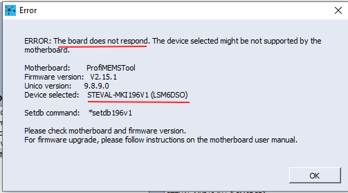

One thing to add as well is, we tried the STEVAL-MKI196V1 on the ST MEMS motherboard STEVAL-MKI109V3 with the Unico software. And we are getting an error result when we try to connect with the Unico software. Stating that the board does not respond. We are not sure if the software means the motherboard or the sensor board (Attached picture below).
This is not the case for the STEVAL-MKI159V1 as we are able to connect easily with this board.
Any suggestions for what is missing? We really want to use the ST sensors for our product.
This is very strange... the Unico version and the FW are updated. Can you please try to plug the STEVAL-MKI196V1 on the STEVAL-MKI109V3 in the reverse direction? And can you please send me (more zoomed) a picture of the top marking of the device, in order to check if it is effectively an LSM6DSO device? I would also ask you if you have tried more than one STEVAL-MKI196V1...

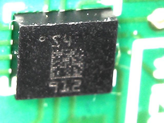

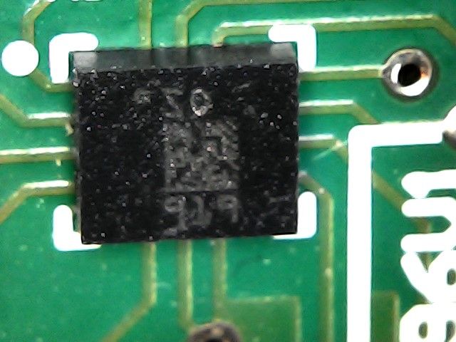

So, we took a picture with our microscope (tried to have the perfect lighting to reduce reflection to the camera lens) for the STEVAL-MKI196V1 & STEVAL-MKI197V1.
Below is the zoomed picture for the STEVAL-MKI196V1
As you can see from the picture, the device part number is S0 - 919.
And below is the zoomed picture from the STEVAL-MKI197V1
As you can see from the picture, the device part number is S4 - 912.
On the other hand, the datasheet doesn't state the part number that should be written on the LGA package.
Honestly, we currently have one board, but if you think it makes sense to order another 2 we wouldn't have a problem ordering more STEVAL-MKI196V1
We will make sure, that when we are not using the STEVAL-MKI109V3 that we adhere to pin initialization values on p.7 and p.8
But are these part numbers correct?
Merci Beaucoup!

Hi @KShar.4
Part numbers seems OK

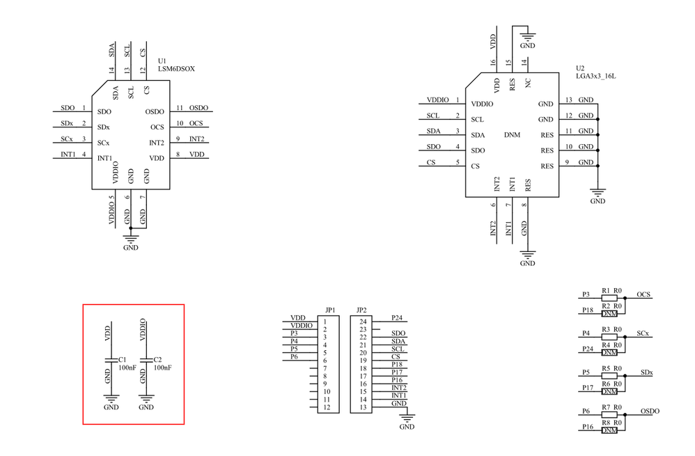

But of course this doesn't last long, as the capacitors (C1 & C2) on the MKI197v1 will fully discharge. But they did function when they were discharging!
This gave us the indication that something is not right with the voltage levels. (Vdd and Vdd-IO)

>> we would like to know if the sensor LSM6DSOX part number (S4 - 912) functions at 3.3v?
I confirm you both, i.e. the DSOX part number is indicated with S4 (912 means that the chip lot has been assembled and tested in 2019 wk12) and that the IMU works well at Vdd = VddIO = 3.3V.

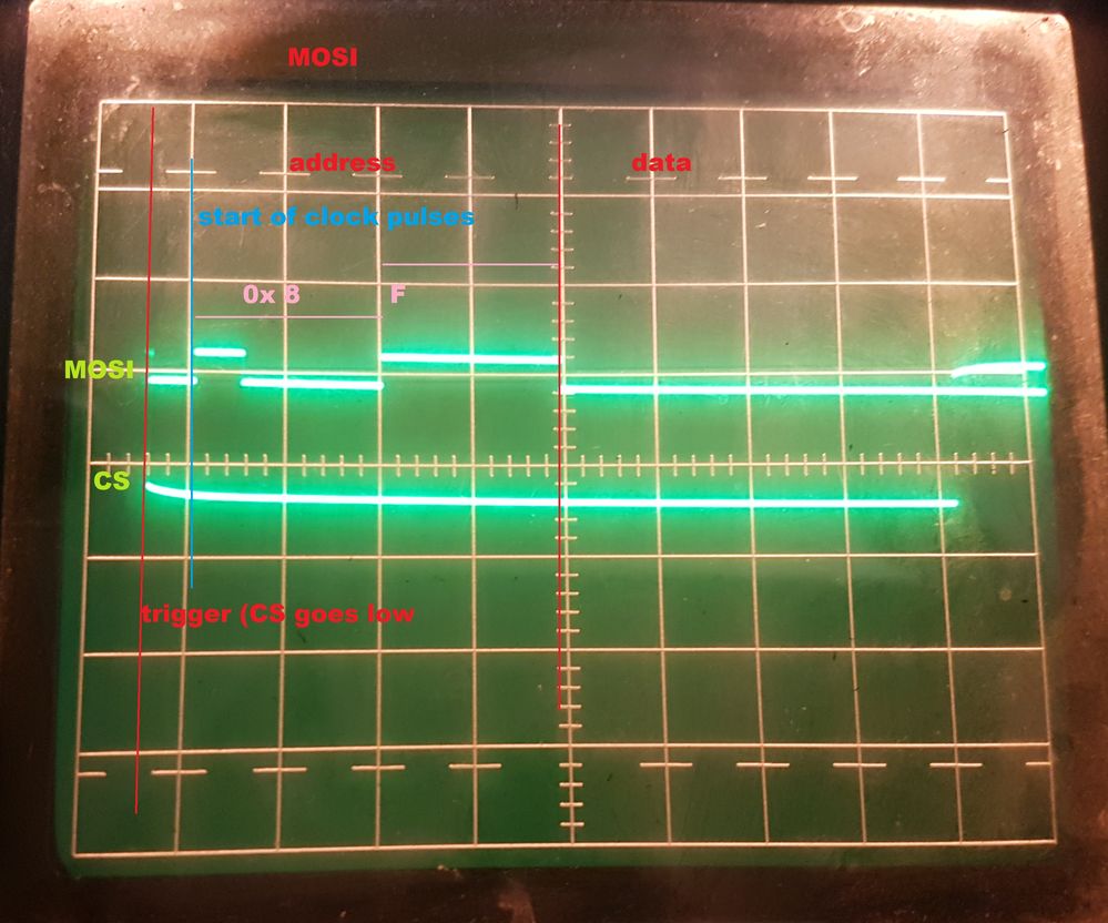

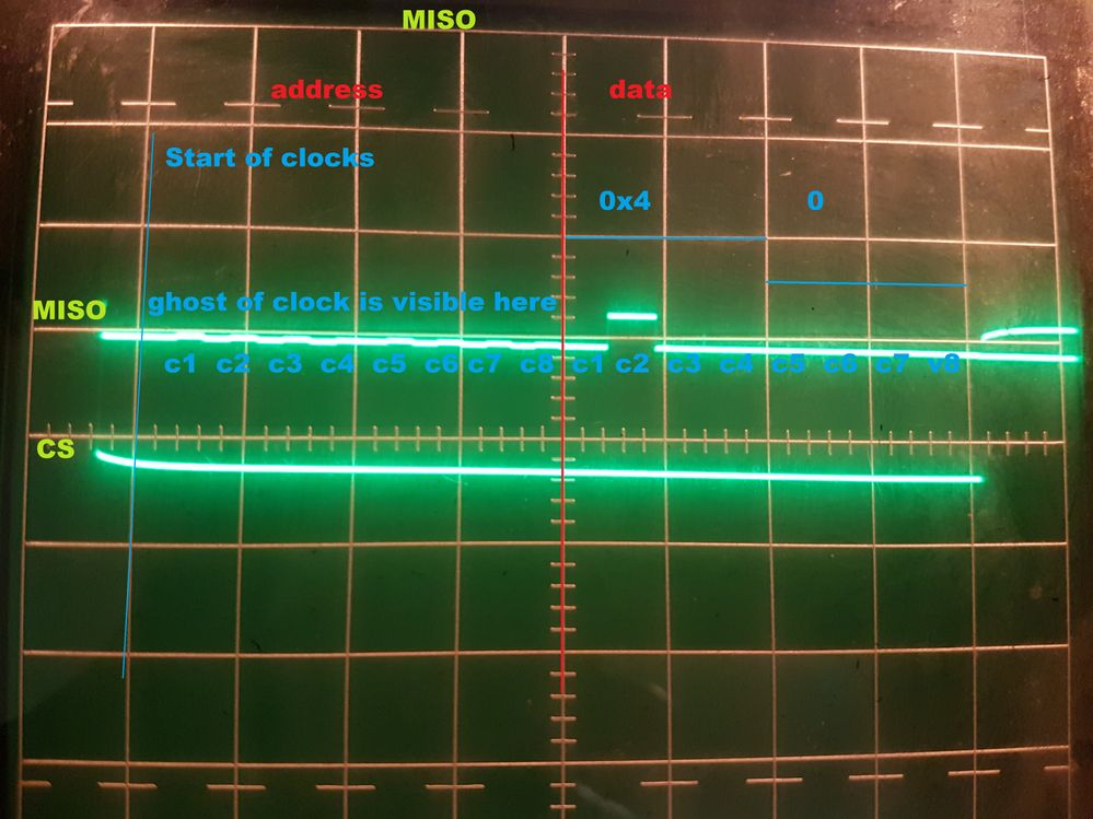

As usual I am trying to read WHO_AM_I as my test. In software (keil compiler) I can consistently read 0x40 from WHO_AM_I. I mean very consistently, thousands of reads in a row will return this value. When I put it on the scope. I can clearly see that the LSM chip is replying with a very clear 0x40. The waveform is crisp (this will happen at any SPI speed but i do testing at ~200khz so it shows up good on my ancient analog scope)
This is 3 different prototype boards. They all behave exactly the same, replying with 0x40. I have connected two channels of my scope to the clock and data lines, and gone over it with a careful eye to confirm that the waveforms are conforming (they are).
Now, 0x40 is actually the "beginning" of the correct reply of 0x69 (im not sure why the previous poster mentioned 0x68 and 0x6c but the datasheet clearly says 0x69). the first "1" bit of 0x69 is actually the bit located at 0x40.. ( 0x40= b0100 0000 , 0x69= b0101 1001) so the MSB and MSB-1 of the replies are the same, but then they diverge.
I should mention now that since I am using an analog scope with no memory, I have the STM32 chip programmed to read WHO_AM_I repeatedly 1000 times per second. This makes a solid trace on my scope composed of hundreds of separate trials superimposed.
I finally decided to do a bit of a sanity test, and I simply removed the MISO wire from the breadboard, so that the wire was ONLY connected to my scope probe, and not to the Nucleo board at all. Suddenly, I could see the correct value of 0x69! As soon as I plug the wire back into the Nucleo board (still scoping it), the response turns back to 0x40. This is actually how I noticed that the first two bits of 0x40 and 0x69 are the same. On the scope, the waveform for the first two bits looks exactly the same when the LSM replies 0x40, or when it replies 0x69, except in the former case, the LSM output transitions to "0" after the MSB-1 bit, and stays there. It transitions exactly on the correct clock edge as if it was actually meaning to output 0 values for MSB-2 onwards. The single bit of the 0x40 is exactly the correct width to be a single bit. The waveform is crisp and square as if by some logic it gave up after the first bit and decided to send the rest as 0.
I know the original person said that they were receiving 0x50 which is actually not part of the number 0x69 but I think it is possible their other SPI settings were not optimal because the waveform for 0x40 and 0x50 are the same (single pulse, just different length) and I was able to sometimes receive 0x50 in my DR if I had my CPOL or CPHA set wrong...
so ANYWAYS
I tried some ways of loading down the pin to see if i could get the same results. Connecting the MISO pin to other pins on the STM Nucleo board all resulted in the 0x40 reply. I tried it on a pin I specifically configured as a normal GPIO input (B6 I think), same 0x40 reply. Connecting it directly to ground or 3v3 with a 1k resistor, it still replies 0x69 as it should with 4mA drive capability. But when I connect the 1k resistor in series between MISO and the STM32f, it replies 0x40 again! So strange...
I settled on a resistor that was about 2.2k. At this value the LSM replies 0x69, and although the waveform is severely degraded on the STM32 side of the new MISO resistor, I can read the chip semi-reliably at 10mhz (although based on the waveform I would never send that to production)
So... what is going on here. Are these little breakout boards doing something fundamentally wrong? are we dealing with fake chips? bad batch? something weird about voltages? Oh yeah I am running it off of the 3.3v arduino connector pin on the Nucleo board, the whole system should be on the same 3.3v supply.
One other thing I should mention... I had used one of the "purple" boards in I2C mode on another project and that worked great, no problems, I even "overclocked" the I2C to 1Mhz and it worked fine. Same exact specimen that cannot do SPI properly..
We actually have a fully assembled prototype PCB on order with the LSM already connected directly to the STM chip on a single PCB, which is actually not our first time doing this, and it has always worked fine for us. Thats why this is confusing. This is not my first LSM project. Im really hoping that will "just work" and I can forget about these crappy little breakout boards altogether.. but its still frustrating that they dont work, I meant to save myself some time but I ended up just wasting it.
I suppose I can just limp by on my 2.2k resistor until I find out if our PCBs work
