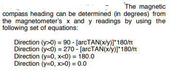

Calculation:
Edit:
For anyone with this problem, the sensitivity of the sensor is, for whatever reason, better on its side! This was just a slight offset that can be corrected by plotting your values and centering them around the origin (0,0).

You have to compensate the tilt.
For the theory you can read application note
.if you don't want to develop it by yourself you can use our eCompass library (MotionEC) which is available in
package.2018-04-06 2:19 PM
Yeah, there was an offset in both readings; when the sensor was on it's side it did have a better performance though. When I centered the 'magnetic circle' around the origin I was able to get a great response from the sensor!
