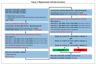

The self test procedure is outlined in AN4825. Follow that exactly and show the numerical results you get along with relevant code.

Hello ST Community,
I shared complete example of the LSM303AGR magnetometer self-test, based on AN4825. This was tested on an STM32 platform using HAL over I2C. Below is the implementation and test results.

Output:
Self-test ENABLED: CTRL_REG3_M = 0x12
Self-Test Results:
X: nost = -106, st = 35, Δ = 141 [PASS]
Y: nost = -186, st = -61, Δ = 122 [PASS]
Z: nost = 356, st = 412, Δ = 58 [FAIL]
LSM303AGR Magnetometer Self-Test FAILED
