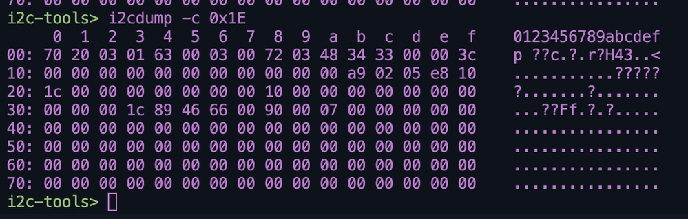

I am using an LSM303 sensor, connected via I2C to an ESP32 and programmed via ESP-IDF to retrieve the magnetometer and accelerometer data. I was previously using an Ardunio and the the Pololu LSM303 library and everything worked with the same wiring.
However, when using bare i2c in ESP-IDF, it seems like I have messed something up as the magnetometer data freezes unless I power cycle the LSM303 (rebooting the ESP32 doesn't seem to change the readings, while unplugging the VCC of the lsm303 and plugging it back in again results in new readings).
Here is the code, which reads the data at 50 Hz via I2C. I have checked various sources including the stack exchange electrical engineering forum and others but I am worried I missed something that may actually be quite obvious.
I have followed someone's advice to set "ODR[0:3]" to 220hz, which I believe I did as confirmed by a i2cdump (I assume it is chip 0x1E register 0x00) has hex 0x70, which is equivalent to 0b01110000.
Here is the i2c dump for reference:
Just for reference, here is the Code related to the i2c implementation, using ESP-IDF

2023-04-15 10:21 PM
Solved:
Needed to change: Chip: 0x1E Address: 0x02 Data: 0x0
I ended up going through the data sheet and checking the i2c dump 1 by 1 and found out!
The reason for this is in P.38 of the data sheet: https://www.st.com/resource/en/datasheet/lsm303dlhc.pdf
MR_REG_M(02h) needs to be set to 0,0 to be in continuous conversion mode (the i2cdump revealed it was 0x03, which is 0b11.... in binary, representing sleep mode), but we want 0b00.
Thanks for all the help.
2023-04-15 10:21 PM
Solved:
