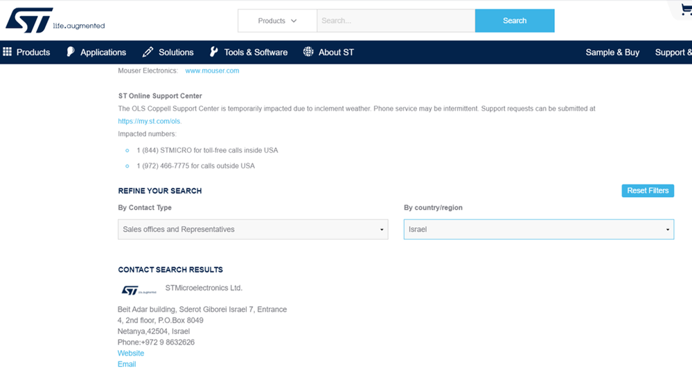

I suggest you to contact a representative from your region the from the st.com contact page, to get more support and internal visibility -and eventually escalation- on this quality issue.
-Eleon

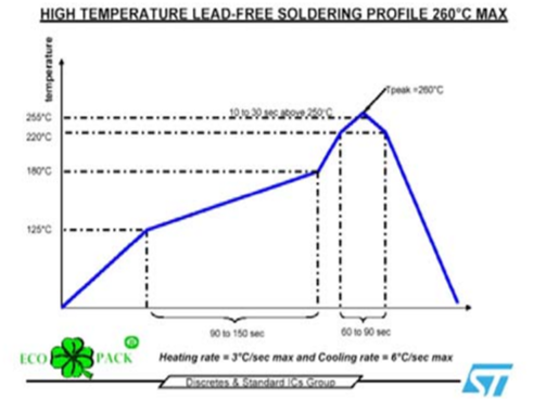

However, comparing it with the one in AN4450 application note (Hardware and software guidelines for use of LPS25H pressure sensor... well it's another pressure sensor but the soldering profiles are all very similar):
0693W000007DEs6QAG.pngI would suggest you to increase the speed of cooling ramp from 1°C / sec as in your case to at least 2°C/4°C / sec as in the above picture.
Moreover, in AN4450 application note you can find other considerations to be taken into account:
In using non self-cleaning solder paste, proper board washing after soldering must be carried out to remove any possible sources of leakage between pads due to flux residues. However, take care not to perform the cleaning process on top of the pressure sensor.
Let me know if you can try the modified solder profile.

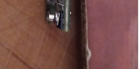

Attached another pic from another Board.
