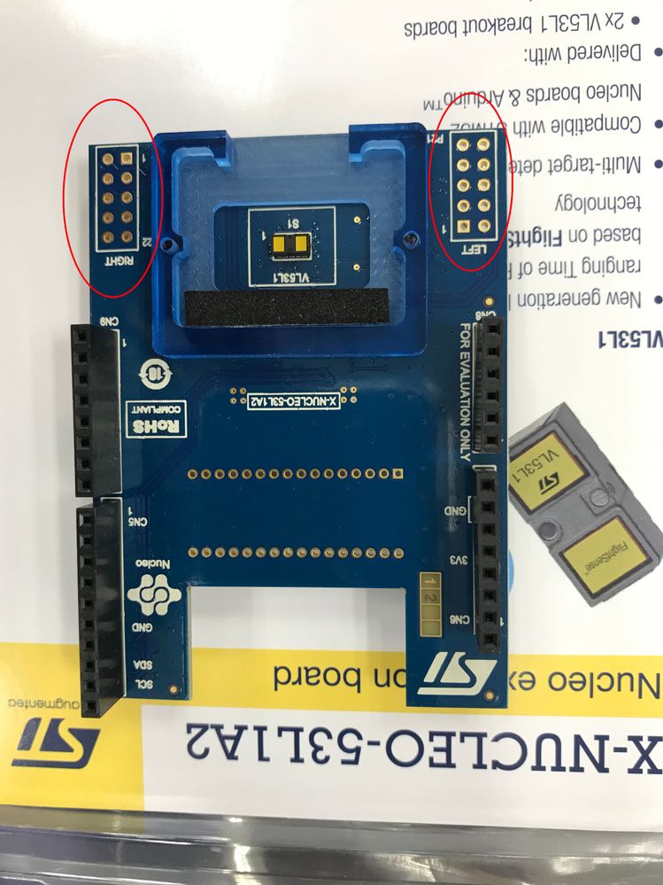

I purchased X-NUCLEO-53L1A2 and tried to check the function.
However it was impossible to connect VL53L1 breakout board through left and right connectors.
Because there were not left and right connectors. I attached the picture.
But about X-NUCLEO-53L1A1, there are left and right connectors.
I'm wondering why there are not those connectors on X-NUCLEO-53L1A2.

2021-02-19 7:31 AM
You are correct. The header is not on the board.
While we decide what to do, you can buy the connectors from digikey or mouser.
https://www.digikey.com/en/products/detail/samtec-inc/SSQ-105-01-T-D/1110763
Or any other 10 pin female 2.54mm pitch 2x5 would work.
I'm really sorry.

2021-02-21 5:03 PM
Dear John
thanks for your replying.
I have a question, the board is fault? (I mean no connector is mistake at your factory.)
2021-02-22 6:27 AM
It was not a factory fault. We are really good at that part.
But when the board was modified from an existing part (the X-Nucleo-53L0A1), we failed to get the correct Bill Of Materials.
And so those connectors were left unsoldered.
Unfortunately we found out about it at the same time you did - after they had been shipped to distributors.
We are still working out what to do about it.
