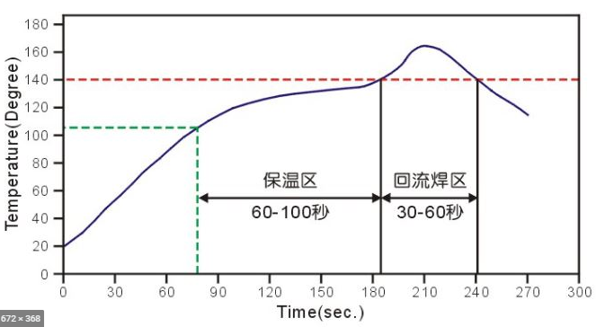

I managed to solder about 20 HTS221 on my custom board using a small oven, some boards have a correct temperature and humidity measurement, but others are out of luck.
issue 1:
temperature stuck around 35C, in my room at 24c, changes on the temperature on the sensor surface e.g putting a finger above it, makes it change few decimals above or below 35c
issue 2:
I noticed a huge inconsistency with the humidity reads, I am almost a constant 55% humidity, and some boards, read 41%, 80%, 99%, 130%, 1460%!!, why this inconsistency? I know after soldering I have to re-hydrate the sensor, but it has been at 25c and 56% humidity for almost 2 weeks, and still the same inconsistency.
I am doing the soldering by myself using a small oven following the reflow profile below for a Clean Lead Free Low Temperature Solder Paste which melt around 141c
in some custom boards, after I noticed the issue with the humidity/temperature reads, I change it manually using a hot air gun never exceeding 160c for my soldering profile, and the issue persist, I tried with some sensor replacing them 6 times in row presenting the same issue as well

Hi @JISEA , thank you for the detailed explanation of the issue. A few points to be clarified:
About the soldering phase, especially if the temperature is not fully controlled, you need to absorb the residual humidity from the package. So you should perform a 1 or 2 days of re-hydration process
